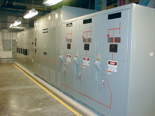

Large dry-type distribution transformers are typically fed by medium-voltage power systems (12.47kV, 13.3kV, or 13.8kV) and feature a secondary voltage rating of 480V, 3-phase (Photo 1). Some of the larger common sizes of dry-type transformers available today include 500kVA, 750kVA, 1,000kVA, 1,500kVA, 2,000kVA, 2,500kVA, 3,000kVA, 3,750kVA, 5,000kVA, and 7,500kVA.
