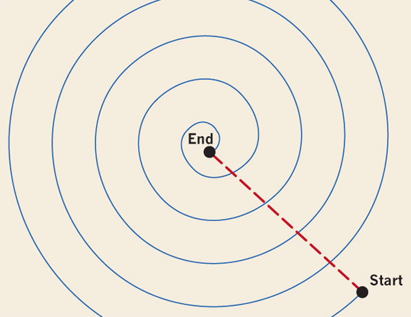

Fig. 1. Sample design iteration sketch.
Design is an iterative process. The more a design is reviewed and revised, the more refined it becomes. As soon as we create a model of our design, the iterative cycle begins, as is illustrated by the spiral in Fig. 1. The line, intentionally dashed, represents the shortest — yet most difficult — route to a solution.
BIM offers the ability to facilitate iteration dynamically. Designers can see changes, make choices, and finalize decisions quickly and earlier in the process. This is a departure from the past, where numerous drawings were marked up to reflect even a single change. But as the design industry has evolved from hand drafting to two-dimensional computer-aided drafting (CAD) to three-dimensional BIM, it is interesting to explore what we have gained — and perhaps lost — along the way.
