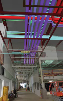

Through the advent of BIM, construction teams can reduce the risk of installation through better visualization and the ability to build a project virtually before it is constructed in the field, says Morris. Following is a quick case in point. EMCOR is now a leader in the health-care market and works on some of the largest hospital projects in the world. Yet, 10 years ago, the company found this to be a very difficult market due to repeated challenges with the amount of wiring and conduit compressed into the ceilings.
“Years ago, we would do a job walk, and they would have a dozen ceiling tiles popped out,” says Morris. “You would get on a ladder, take photos of the rat’s nest, and then put a bid on it.”
Rather than just doing a visual inspection, EMCOR now is able to capture data through a variety of methods, including BIM authoring tools and 3D scanners. These technologies have made the difference between success and failure in the health-care market, says Morris.
For EMCOR, these types of devices help cut through the complexity. For example, the company worked on a retrofit project for a higher education facility, which required a very complex installation. Instead of going out in the field with a pencil and pad of paper, the team was equipped with digital tools and scanning and surveying equipment. The contractor could then work hand in hand with the architect and engineer to deliver a successful project.
“While it was small, the complexity drove us to use the tool and ultimately gave us the positive outcome,” says Morris. “Five or 10 years before, it would not have been the same process, and we would have probably ended up with claims for additional time and work. With the technology and our trained personnel, we could use that to our advantage.”
