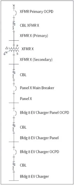

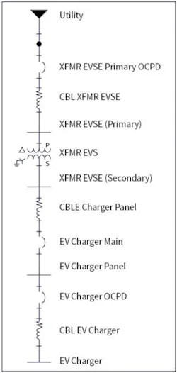

Most buildings have the power system shown previously in Fig. 1 with the dedicated transformer for EVSE and then subsequent downstream equipment for EV charger. Building 8 and Building 9 have a different power system for EVSE as shown in Fig. 3. These buildings have a separate EVSE distribution panel but share a common transformer — larger in size compared to the other buildings.
The common trend for all the buildings is that the incident energy in the EVSE distribution panel is directly proportional to the transformer size, where the transformer is dedicated to the EVSE. There was a slight difference in incident energy for the EVSE distribution panel, which had an electronic trip unit in its MCB, compared to the fixed trip unit counterparts. The average arc flash boundary is 48 in. except for the panel being fed by a 112.5kVA transformer. Most of the EV chargers were about 8 ft to 10 ft away from the parking lot for all buildings.
The incident energy for all EV chargers was significantly lower than for EVSE. This is a typical result found in arc flash hazard calculations since this equipment is downstream of the EVSE transformers. The average incident energy is 0.13 cal/cm2, and the arc flash boundary is about 4 in. Most users are always out of this arc flash boundary while using the chargers, and the charging plug is almost 5.2 in. long, which is outside of the arc flash boundary.
