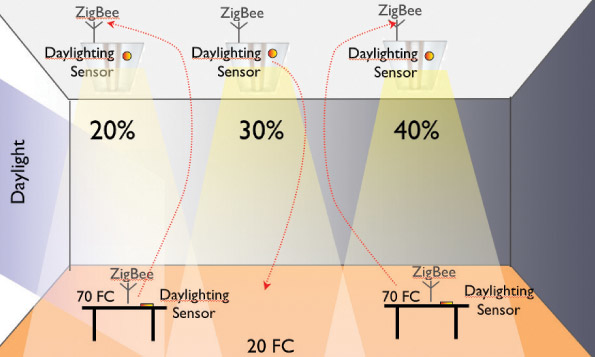

Another manufacturer in the lighting industry, with wide experience in data networking, now offers a sensing and control system for commercial lighting that places a variety of such sensors in a single, small module so that a number of ambient conditions can be measured. The module can be located adjacent or within a luminaire. In addition to detecting the light level at each fixture, other ambient conditions, such as temperature, carbon dioxide level, carbon monoxide level, air pressure, air velocity, humidity, particulate, and color, can be recorded. The company developed this sensor based on the idea to shift from simply using energy to managing it.
A sensor built into the luminaire that automatically responds to its environment — whether it’s occupancy, available daylight, time of day, or other variables — and delivers just the right amount of light when and where it is needed is the perfect solution for reducing energy consumption and costs. Rather than applying controls as an afterthought, this built-in approach maximizes energy efficiency.
In the simplest case, as more or less ambient light is sensed by the lamp, it responds in the opposite direction with more or less output in order to maintain a preset target illumination level. When communication and networking functions are wrapped around the sensor/microcontroller combination, a more sophisticated set of interactions is enabled. For example, as daylight increases, theluminaire would not only respond autonomously, but it also would report a response to nearby luminaires. This would enable the device to act in coordination to “balance” the light seamlessly across not only the space directly affected by the daylight, but also in adjoining areas that are more influenced by the dimming luminaires. With low-cost and low-power wireless networking (such as ZigBee), or wired networks, group intelligence and centralized control systems can be implemented readily.
