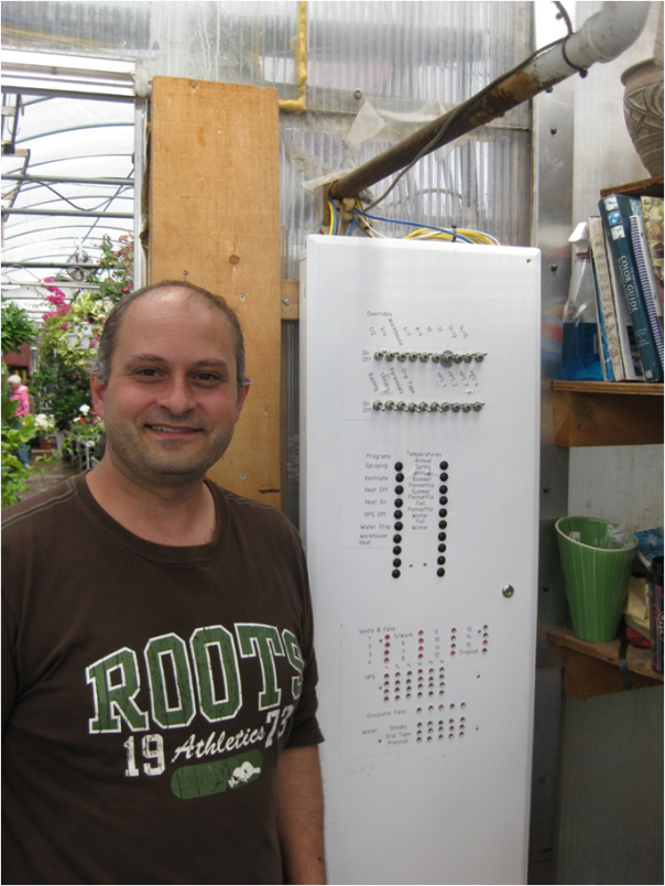

Levetsovitis felt the system could take on the challenge of controlling the environment for the nursery, ensuring that the heating, ventilation, lighting, and water usage were correct for the million living plants. He also had to integrate gas-fired CO2 burners, which increase the level of carbon dioxide in the greenhouse air to encourage the plants to grow faster, into the system. The nursery’s four Priva burners provide the needed CO2, and they also produce heat and water vapor needed for plant growth. “They look like jet engines,” says Levetsovitis, explaining that to keep the CO2 level of the burners at legal limits, they are monitored with thermostats and CO2 detectors. “The sensors are important for the system to precisely monitor the CO2 level. If the system detects that the level has exceeded the threshold, then the HAI by Leviton system shuts them down.”
