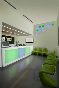

Tunable color capability allows lighting designers to create exciting new LED lighting systems in this dental office (Photo courtesy of Acuity Brands).
