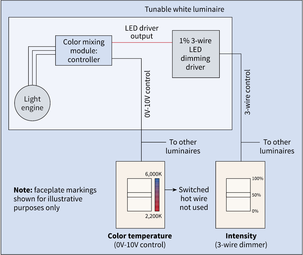

The second type of tunable white luminaire uses one control input for intensity and the other for color temperature. The control inputs for these luminaires are typically 0V to 10V or digital control. Implementation of this method requires a driver that has the capability of dynamically mixing its output (using two or more colors) to generate the requested intensity and color.
The Figure depicts one such implementation: two slide dimmers are used to control a luminaire. One dimmer is used to provide the intensity control signal to an LED driver while the other dimmer provides a 0V to 10V signal to the luminaire’s controller for color temperature control. The color mixing module interprets the 0V to 10V signal and sets the LED light engine to the correct color temperature.
Unlike solutions with warm/cool control inputs, this system is much more flexible. Users can easily set an override of the intensity at any color temperature. For example, a timeclock can be used to vary the CCT throughout the day, while allowing for intensity overrides by occupants.
This method also allows the users the flexibility to have presets for CCT and a raise/lower for intensity. This could be in the form of a four-button keypad (e.g., 6,000K, 5,000K, 4,000K, and 3,000K) with a raise/lower control at the same location for intensity. All common sequences of operation can be supported in the same way as in non-color-tuning situations (daylighting, load shed, etc.).
