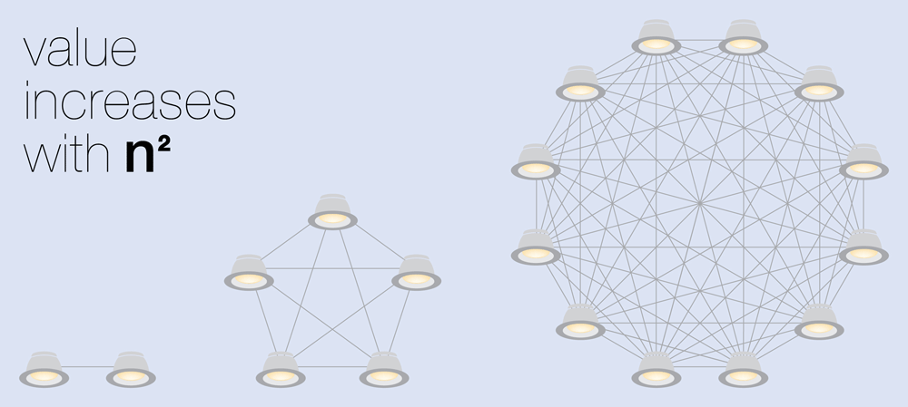

Bluetooth mesh is structured as a “flood network,” communicating with all devices within its vicinity at once. Bluetooth mesh sends every incoming data packet to every outgoing connection and shares it across a lattice of Bluetooth devices (Fig. 1). Each packet can carry up to 384 bytes of data, although most messages will fit in an 11-byte frame. Eleven bytes is more than enough for machine-to-machine (or luminaire-to-luminaire) communications. Each packet includes one byte of opcode for special messages, 2 bytes for standard messages, or 3 bytes for vendor-specific messages, as well as a source and destination address, and sequence numbers to prevent replay attacks.
Bluetooth mesh is scalable and fast (up to 1 Mb/sec data transmissions). The mesh design ensures there is no single point of failure, which is why the Bluetooth mesh topology is more robust and reliable for wireless communications. All devices that are qualified by the Bluetooth SIG are guaranteed to be interoperable, and the mesh design is self-healing so you can add or remove devices without disruption — or if a signal is blocked the mesh automatically reroutes the data to compensate.
