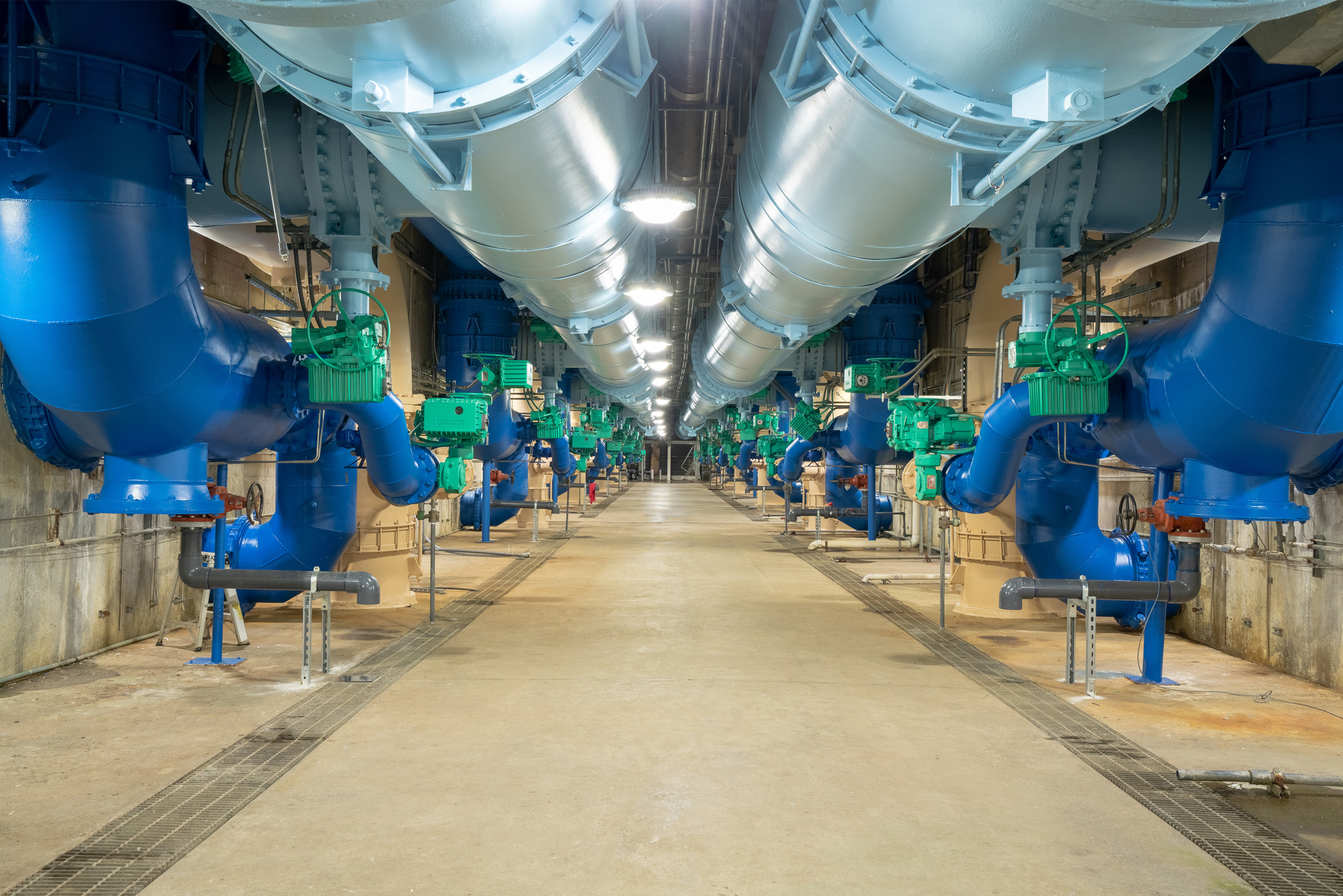

In addition, the dingy, distorted color of the metal-halide and high-pressure sodium lights also caused visibility issues. Workers had a hard time distinguishing between green and blue colors on various pump motors and visually inspecting the water to detect septic conditions.
The plant facility management team ultimately decided on Dialight LED streetlights, high-bays, low-bays, flood lights, and area lights to replace the plant’s current system. A total of 259 fixtures (ranging from 33W to 212W) were used, both reducing the total fixture count and slashing 446,576kWh from the plant’s annual energy consumption.
The project also qualified A.B. Jewell for a $32,000 rebate incentive from its energy provider, the Public Service Company of Oklahoma, which covered almost 20% of the retrofit’s cost and brought the payback period from 8.1 years to 6.6 years.
“It’s been a complete 180,” said Curry. “You can actually see into the equipment pits, and even the contractors that were here before the lights were switched out are so impressed. We get compliments from the guys working in the building, and morale is definitely higher.”
