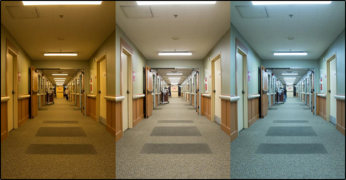

Three long-term-care corridors featured lighting settings that mimicked the facility’s former fluorescent lighting (static lighting) or that were programmed to change in spectrum and intensity (tuned lighting). The nighttime lighting mode had overhead LED lights delivering 2700 K (warm) ambient light, dimmed to 21% output. The spectrum was designed to minimize blue-cyan energy—the portion of the visible light spectrum most associated with human circadian melatonin levels and, as such, affects sleep quality and duration.
The daytime setting had 100% output at 6,500°K (cool), designed to maximize energy emitted in the blue-cyan range. A transition state between the nighttime and daytime settings had 4,100°K and 100% output.
