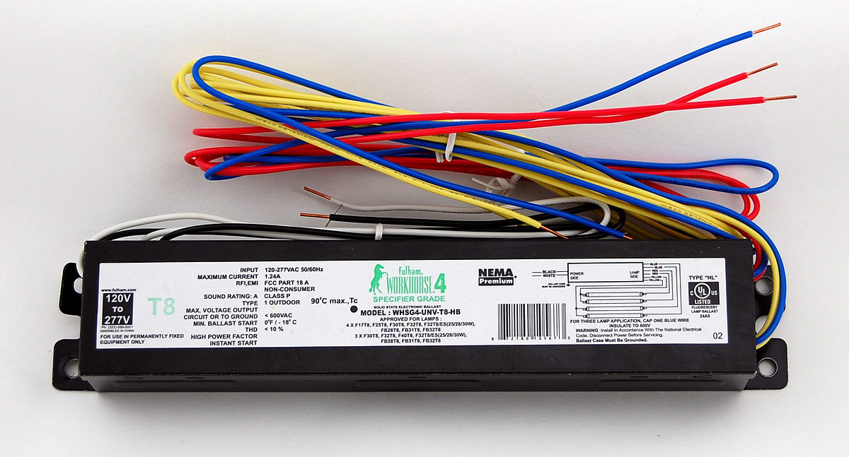

How to solve for frequent lighting ballast failures
The lighting ballasts frequently fail in a high-revenue portion of the plant. Maintenance is quick to respond, and because quick disconnects were installed at all luminaires, the repairs are quick.
However, there are still process interruptions and many complaints from production workers. You’ve just been promoted to plant engineer. Your predecessor took a lot of heat over this problem, and found a job elsewhere.
Your predecessor did one last project before leaving. After noticing the lack of transient voltage surge suppression (TVSS), he hired a contractor to install a power monitor for a few days to look for voltage spikes. Those were discovered and the TVSS installed, yet the problem persists. What’s your next move?
Lighting ballasts can fail for reasons other than voltage spikes. If, for example, large motors generate voltage spikes by starting across the line, they also generate other power quality problems that TVSS won’t protect against.
Complete your predecessor’s foray into power quality issues with a full power analysis. You could solve multiple power quality problems by installing a soft starter or variable frequency drive (VFD) on each motor; consider the feasibility of doing that.
In addition, closely examine the equipment bonding. Does all the equipment on the lighting circuit have a reliable connection to the equipment grounding conductor (EGC) so there’s equipotential? You may find that’s not so; for example, locknuts on luminaires are being used as part of the bonding path.
