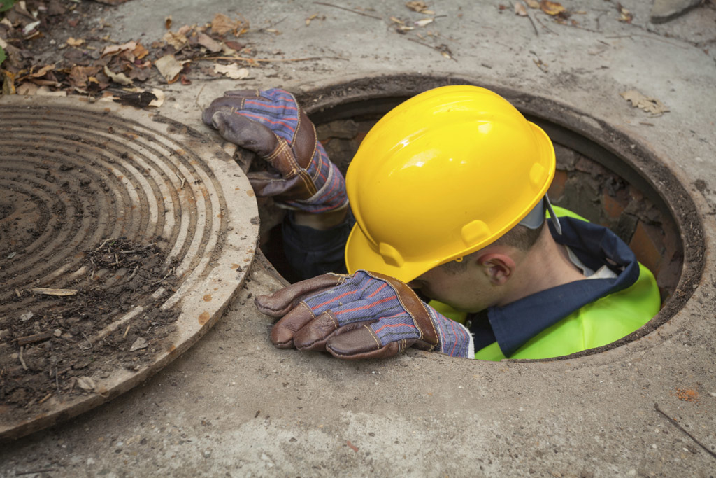

You approach a confined space and see it doesn't have a confined entry permit. Is it safe to enter? That depends. If you can verify the space has been designated a non-permit space, it's safe to enter. If you can't verify that, assume a permit is required and proceed accordingly.
If the space has been designated non-permit and you smell fumes or you're feeling light-headed in there, maybe there's a new danger. Exit the space and report the problem.
Look for these potential dangers:
  • A condition of the permit hasn't been met.
  • A condition prohibited by the permit exists.
  • The permit doesn't mention the specific area in which you will be working.
  • The confined space is wide enough for only one person, but there's no attendant with extraction equipment.
  • You have an attendant, but that person acts distracted, doesn't have a radio, or isn't physically strong enough to extract you.
  • The space contains combustible gas, but there's no fire attendant.
