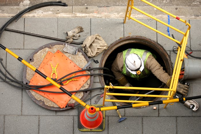

In some instances where electricians will need to work in certain confined spaces like crawlspaces, they may need a permit. A confined space permit is a document that states the safety procedures required when entering a confined space. Supervisors, entry teams, and everyone else on the job site need to be aware of the permit, check it before entry, and make sure all of the equipment listed on it passes inspections. A permit will include the name or location of the site, the specifics of the job, when you’re doing it, the names of the people on site, identified hazards, gas detector readings, an equipment list, and detailed emergency procedures. Dialing 911 does not qualify as a procedure.

For a space to require a permit, it needs to meet the above requirements for a confined space, but with other elements that make entry and work more complex or dangerous, potentially immediately. An example would be a tank or vessel. They almost always have a small entrance or opening with many potential hazards, coupled with difficult means of extracting an injured worker.
Permit-required confined spaces need to meet additional criteria. This can include a hazardous atmosphere or the potential to contain one, where water, grain, or petroleum products are involved and can engulf the entrant. An internal design that can trap or asphyxiate workers inside, especially if toxic gases are present or other safety hazards. Remember that conditions inside of a confined space can change quickly, and even those that weren’t marked as permit-required can require a permit as changes happen.
