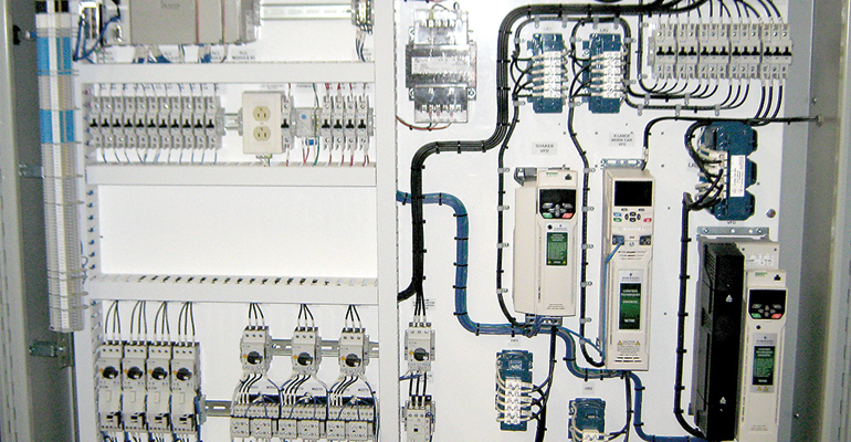

Few business operations can afford unplanned downtime, which typically causes frustration, eats into profit margins, and can lead to workplace injuries, accidents, and health issues. When you have production targets to meet that require the use of equipment, it’s essential that the motors, motor drives, and other machinery runs safely and smoothly. With regularly scheduled maintenance, you can minimize the chance of breakdowns, especially those caused by common drive problems. Follow these steps to maintain drives and ensure controls are running as they should.

Clean air is necessary for all motor drives to function properly, so clean or replace any cabinet air filters as often as necessary to maintain airflow. While it’s ideal to replace cooling fans every two years, it’s also helpful to check them quarterly — and swap out any faulty fans before they fail completely. Deferring maintenance until problems arise is a surefire way to lose productivity. In addition, faulty cooling equipment can lead to the failure of other parts, requiring more costly repairs.
#3: Review connections
Using the drive manufacturer’s torque specifications as a guide, check all the accessible connections at least once every year. When you’ve done so, disconnect all the motor leads from the drive, take insulation resistance readings, and log them for future reference. Ensure the electrical insulation is in good working condition, and measure the winding resistance, which can provide good information about the condition of the equipment and its components.
#4: Replace DC capacitors
DC bus capacitors are a critical component of AC motor drives. Many manufacturers recommend replacing them at intervals. This is especially important for larger drives, which should be replaced every five to seven years, although it might not be practical for smaller drives.
#5: Consider an upgrade
In instances where drives are older and obtaining replacement parts has become difficult, it might be worth considering a drive upgrade or retrofit. For DC drives, a planned replacement with an AC drive and motor may be advisable.
#6: Testing
When all your maintenance work is complete, run the drive at full speed, and take input and output voltage and current readings using an oscilloscope, if possible. Keep a log of all the readings. If full speed operation isn’t practical, run at the fastest steady speed that is appropriate. Uncouple the motor from the load (if required).
