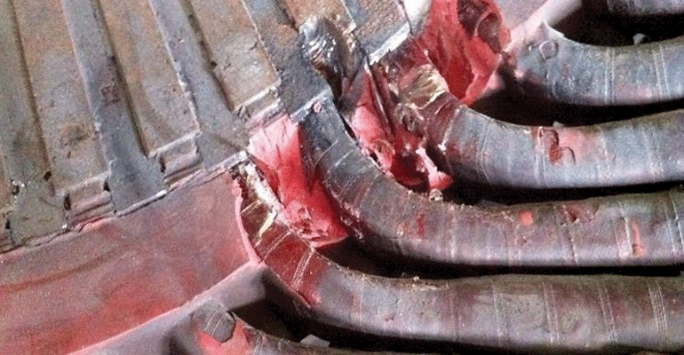

PD occurring in the stator of an electric motor can damage winding insulation and contribute to significantly accelerated aging of the insulation, which can be compounded by a number of other conditions, such as carbon tracking, corona, and the production of ozone gas (O3).
Corona is the physical manifestation of a PD and appears as a faint glowing light that surrounds a conductor at high potential. This is a common occurrence in motors with operating voltages above 5,500V, and methods of dealing with corona discharge in these larger motors have been heavily researched and developed over the years. “Conductive tapes are used as a conductive layer on the coil slot portion to reduce corona discharges that can occur on the coil surfaces. Semi-conductive corona protection tapes are used on the coils at the slot exit region and prevents surface discharges at these locations. The use of these commercially available tapes on high-voltage coils that are processed using the vacuum pressure impregnation (VPI) method, has been developed.” (IEEE, 1995)
Another symptom of PD is the production of ozone gas. When PD occurs, it ionizes the air around the insulation, producing ozone gas. O3 is an unstable gas that is colorless, toxic, and has a strong odor/powerful oxidizing properties that can be harmful to both conductors and the insulation inside a motor. A motor that exhibits high levels of PD and corona can cause the area around it to smell strongly of this gas.
