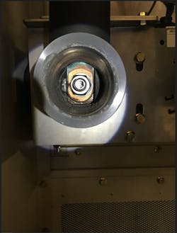

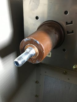

Periodic online monitoring was conducted on 3-phase, 268-m, single-core 33kV cables terminated to switchgear. The remote ends were terminated to a transformer. The PD monitoring system used HFCTs, TEV, and a portable measuring instrument. PD recording was performed at an MV metal-clad switchgear cable termination box. HFCTs were clamped around individual earth shields of power cables, and TEV sensors were attached to the inner walls of the switchgear cable termination enclosure.
Fifty non-consecutive cycles were recorded. With the help of software and algorithms like artificial intelligence (AI) and pulse shape analysis, the data was divided into PD and non-PD categories, as shown in Fig. 3 and Fig. 4.
The investigation further considered data including phase activity, pulse shapes, and phase-resolved PD compared with TEV and HFCT graphs. Note that phase graphs were phase consistent, and pulse-shape graphs confirmed the PD source from Phase C.
The next task is to determine the location of the partial discharges. Comparing the HFCT and TEV data indicated the same activity from both sensors. As this software and monitoring device can capture individual pulses, we further looked at data in the time domain. The same activity was observed in pulse-shape analysis graphs from the HFCT, which was installed on phase C, and the TEV sensor, which was placed on the panel.
Observing Phase C and TEV activity in the time domain (Fig. 5), it was clear that the PD activity was located at the termination end. You can see that HFCT and TEV activity was occurring at the same time at a high magnitude.
When the terminations were opened a few months later, it was clear that there was sparking at the termination, which could eventually break down the bushing connected to the cable (see Photos).
