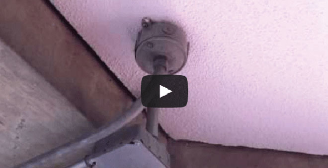

Surface Extension
Russ questions the design of this wiring extension and its accompanying ceiling-mounted box. This is as a violation of Sec. 314.22 of the 2014 NEC.
