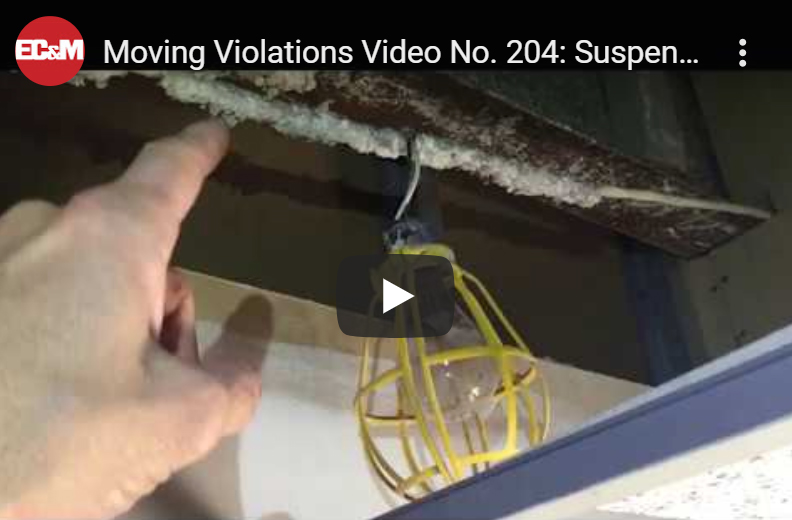

You never know what you’re going to find in a suspended ceiling space. At this location, Russ found some old temporary wiring that was never removed after construction was completed. This is a violation of Sec. 590.3(D) of the 2017 NEC.
