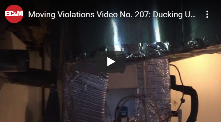

Check out this crazy situation which involves a panelboard hiding behind and under some A/C ductwork. Although we’re not sure who installed their equipment first (the electrician or HVAC technician), we’re left with a Code violation. Russ notes that the limited space in front of the electrical panelboard is a violation of the working space requirements of the 2020 NEC [Sec. 110.26(A)(1)].
