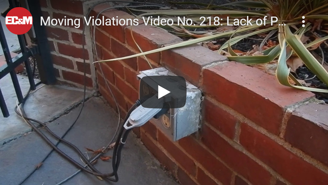

Moving Violations Video No. 218: Lack of Protection for Outdoor Receptacles
In this episode, Russ shows us a violation of Sec. 406.9(B)(1). He points out the improper use of standard receptacles in an outdoor box and highlights why the box cover doesn’t meet the definition of weather tight when a cord is plugged into it.
