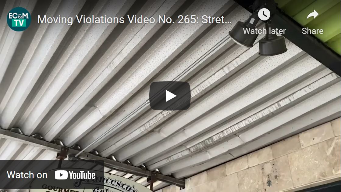

Russ noticed this violation when he looked up at this metal roof structure.
June 16, 2022
Russ noticed this violation when he looked up at this metal roof structure. The electrical metallic tubing (EMT) was installed without any supporting clips, which is a violation of Sec. 358.30(A). It’s required to be supported within 3 ft of the box or termination point and at intervals not to exceed 10 ft.
