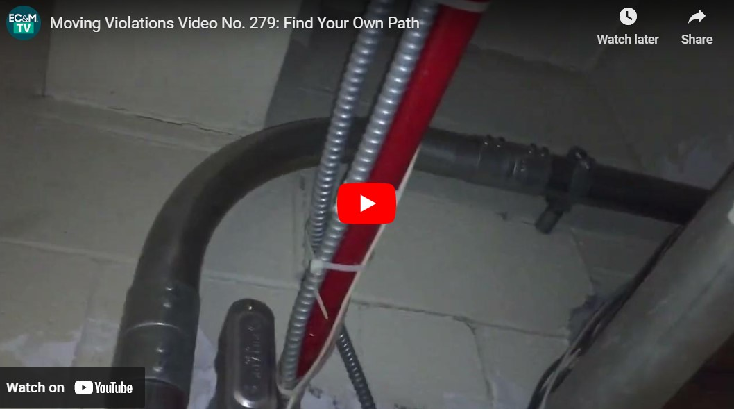

Russ shows us an all too common violation of NEC Sec. 300.11(C).
Jan. 19, 2023
In this episode, Russ shows us an all too common violation of NEC Sec. 300.11(C). This section of the Code notes that a raceway like this electrical metallic tubing (EMT) can’t be used to support other cables or non-electrical equipment. Unfortunately, many installers ignore this rule because it's quick and easy to simply strap the new cables to the existing raceway.
