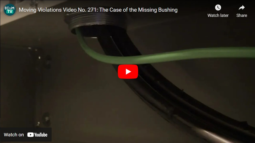

Moving Violations Video No. 271: The Case of the Missing Bushing
Russ shows us what can happen when you don’t protect conductor insulation from sharp edges.
In this video, Russ shows us what can happen when you don’t protect conductor insulation from sharp edges. These conductors were pulled through this metal fitting, which does not have an insulated bushing. The resulting scrapes and gouges on the conductor insulation could eventually lead to a short circuit. This is a direct violation of Sec. 300.4(G) of the 2020 NEC.
