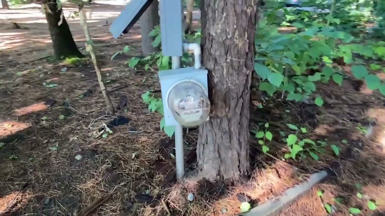

This cord jacket is severely dried and split.
Russ looks at an installation where the cord jacket is severely dried and split open. Section 400.3 requires flexible cords and cables to be suitable for the conditions of use and location. This cord is unsuitable.
