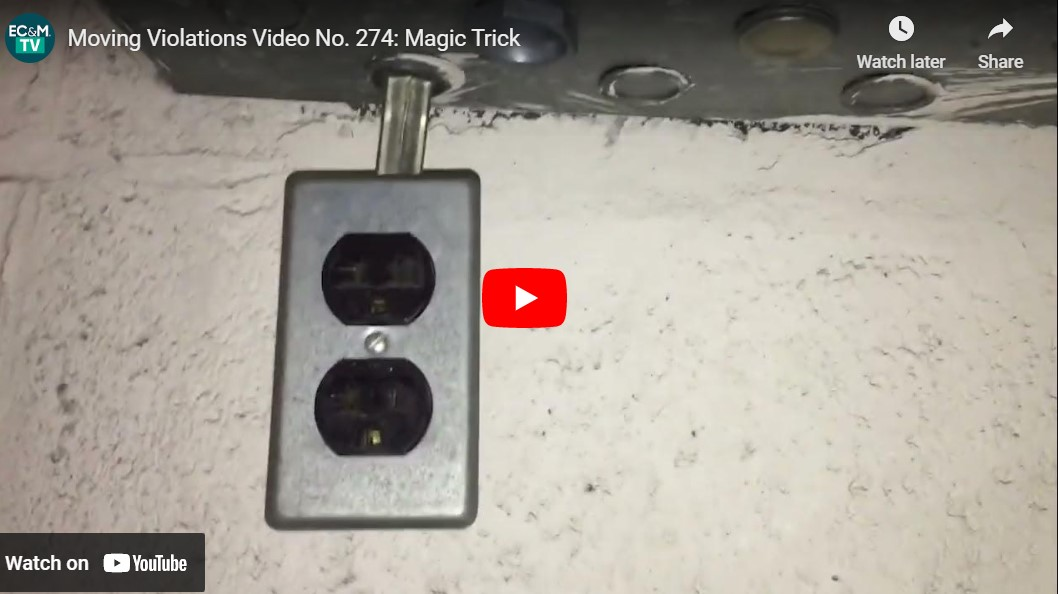

In this episode, Russ entertains us by performing a magic trick. He shows us how an outlet/device box appears to be floating in the air. There are no rules in the National Electrical Code (NEC) that allow us to use an offset nipple to support an outlet/device box.
