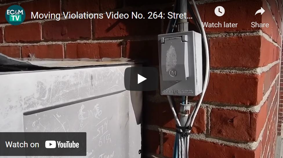

In this video, Russ points out the improper use of set-screw-type connectors in a wet location.
In this video, Russ points out the improper use of set-screw-type connectors in a wet location. This is a violation of Sec. 314.15, which requires equipment installed in wet locations to be listed for this use. Listen to the video and learn about two additional violations at this location.
