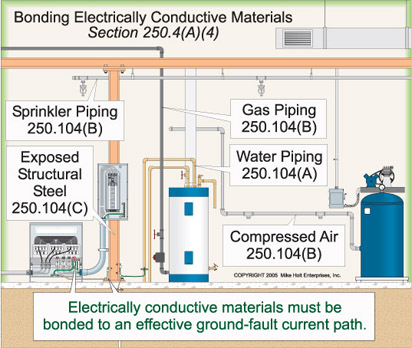

To remove dangerous voltage from ground faults, you must bond metal parts of electrical raceways, cables, enclosures, and equipment to an effective ground-fault current path with an equipment grounding (bonding) conductor of a type specified in 250.118. The fault-current path must have sufficiently low impedance to allow the fault current to quickly rise to a level that will open the branch-circuit overcurrent protection device. In addition, you must bond electrically conductive metal water piping systems, metal sprinkler piping, metal gas piping, and other metal-piping systems, as well as exposed structural steel members that are likely to become energized, to an effective ground-fault current path. A permanent, low-impedance fault-current path is one that facilitates the operation of the circuit overcurrent device. The earth is not considered an effective ground-fault current path.

To remove dangerous voltage from a second ground fault, you must bond metal parts of electrical raceways, cables, enclosures, or equipment together and to the metal enclosure of the system. In addition, you must bond together and to the metal enclosure containing the system to electrically conductive materials that are likely to become energized.
You must install electrical equipment, wiring, and other electrically conductive material likely to become energized in a manner that creates a permanent, low-impedance fault-current path from any point on the wiring system to the electrical supply source to facilitate the operation of overcurrent devices should a second ground fault occur on the wiring system.
