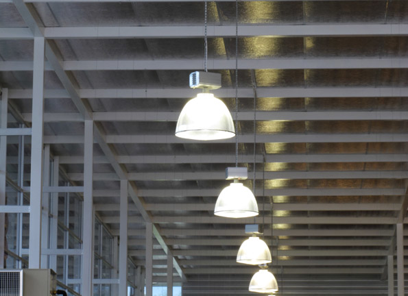

Typically, but not always, you can simply add up the VA of the branch circuits to determine the VA on the feeder. For example, a feeder supplies 10 branch circuits for lighting at 452VA each. That totals up to 4,520VA. But what if those are HID lights, commonly used in high-bay applications (Photo)?
HID lights are an excellent choice for many reasons, but the downside is their ballasts make them nonlinear loads. This has some ramifications.
First, you’ll probably want to derate the conductors. This is especially true if you have long runs, and voltage drop comes into play. The good news is that manufacturers of highly nonlinear loads like HID lighting typically provide derating factors. And because high-bay lighting is a ceiling application, you also must account for the higher ambient temperature using the correction factors in Tables 310.15(B)(2)(a) and (b).
Second, this type of load means you have to treat the neutral as a current-carrying conductor [310.15(B)(5)(c)].
