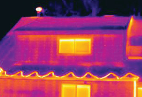

The installation requirements also help ensure reliable operation. Additional hazards may arise if one of these systems fails. Consider a roof melting system (Photo 1). Frozen material can form a dam that traps water (plus more ice and snow) on the roof. The weight of all this may collapse the roof. Similar logic applies to bridges (they need to drain), along with the need to keep them safely traversable for vehicles.
Photo 1. This infrared image shows the roof heating element (bright squiggle near edge of roof). Various types of contractors looking at this same image would have their attention drawn to other information in this image. Can you can identify a few things they might see? (Photo courtesy of FLIR)
Photo 2. This is essentially Photo 1 taken in the visible light spectrum. You can see the melt pattern around the heating element, but you can’t tell if it’s actually on at the moment (Photo courtesy of FLIR).
To avoid callbacks, perform functional testing when the installation is complete. But how? An efficient way is to turn the system on, and view the installation in infrared. Without this type of testing, you’d have to wait until it snows to visually verify operation (Photo 2). It’s better to fix any problems before the snowfall than be made aware of the problem after the roof collapses.
