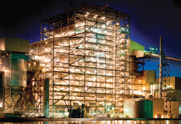

The Plum Point Energy Station plays a vital role in supplying baseload power generation to a rapidly growing southern United States. Among many other considerations, Black
