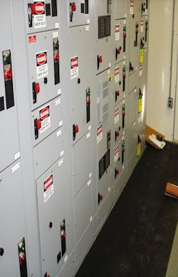

A typical distribution substation with 480V motor control center.
For distribution substations, many times the medium voltage feeds step-down transformers outside the building or enclosure of the substation, which, in turn, feed switchgear or motor control centers (MCCs) with a reduced voltage inside the substation. Many times, these systems are double-ended with more than one source feeding the substation equipment. The result is there are many instances in industrial plants where the distribution substations do not have one centralized disconnecting means for a substation. In fact, in many large substations, it is possible to have a dozen or more sources entering the structure or building. So, the question is: Does this violate NEC requirements?
The location of the disconnecting means required in Sec. 225.31 is covered in Sec. 225.32. The general rule is to locate the disconnecting means either inside or outside the substation. The issue in industrial settings is this typically isn’t practical. Section 225.32, Exception No. 1 provides relief from the general rule for industrial facilities under single management and allows the breakers/fused disconnects back at the main substation to be used as the disconnecting means as long as the rest of the requirements are met. This requires having documented safe switching procedures and qualified persons monitoring the installation.
