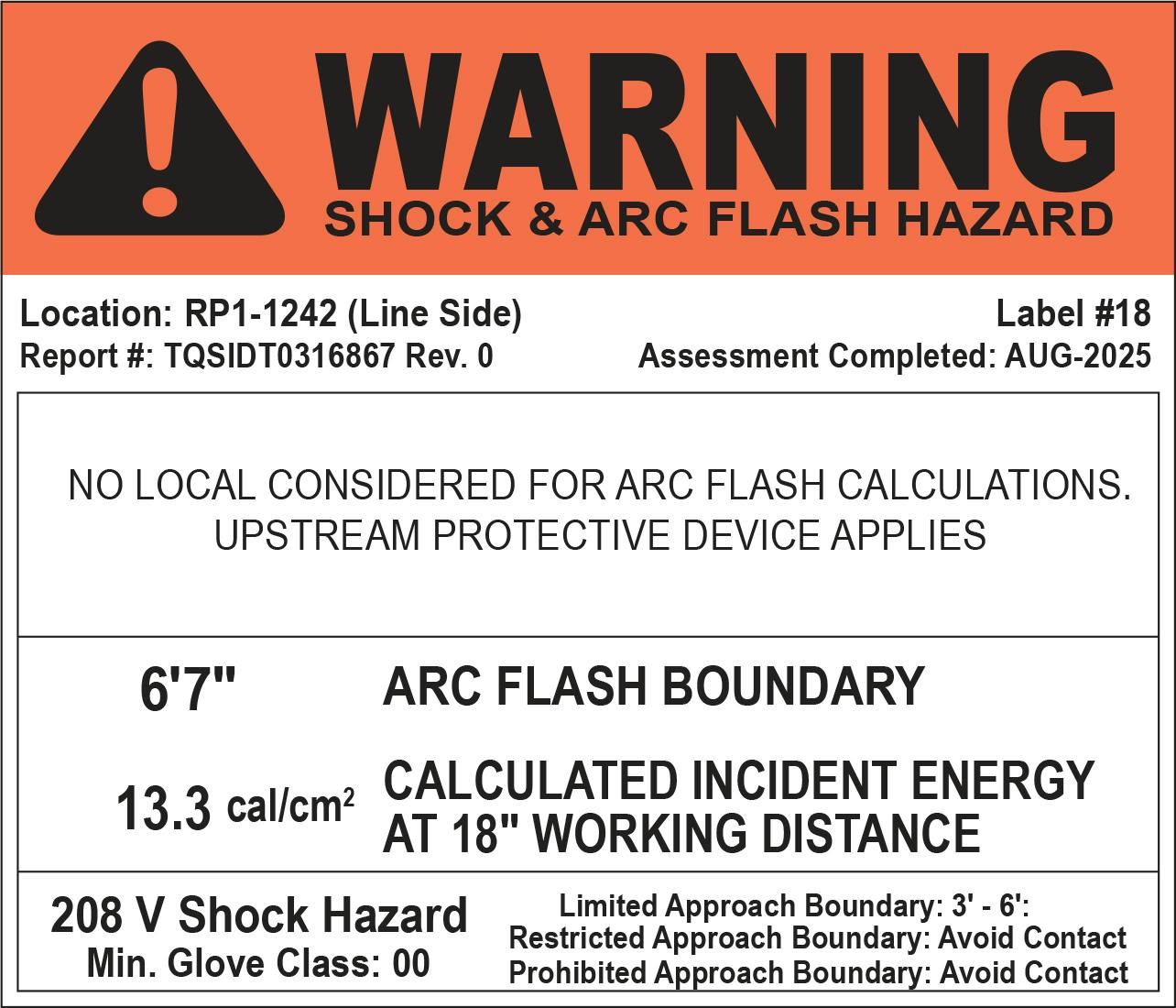

Within the 2023 edition of the NEC, the requirements found in Sec. 110.16 around arc flash hazard warning only applied to service and feeder equipment rated 1,000A or more in other than dwelling units. So, what changed for the 2026 edition of the NEC?
The first obvious change was in the formatting and the renaming of the Section to arc flash hazard “marking” instead of “warning.” Although the terminology “marking” provides some additional latitude, in most cases, it is likely to be done in the form of an arc flash label that aligns with the requirements found in Sec. 110.16. To add clarity, the modifications to this Section also involved modifying the content into a list format for users to help find information more quickly.
Another significant part of the change involved the removal of the 1,000A or more threshold, which means all service and feeder-supplied equipment in other than dwelling units will require an arc flash hazard marking regardless of the size. While the specific types of equipment listed in Sec. 110.16 are examples, being presented with the preface of “such as” means that the equipment listed is not exhaustive in what will require an arc-flash hazard marking.
For example, fusible safety switches for HVAC equipment or motors may require servicing while energized. Because the safety switch is fusible, it means that it is serving feeder-supplied equipment, and it will need to be assumed as energized until it can be opened, with proper personal protective equipment (PPE) being worn, and tested/verified as deenergized.
The requirements for what must be displayed on the label or supplied by the equipment owner are consistent — but how they are displayed may not be. For example, in supervised industrial installations, there may be a QR code posted on the equipment. According to NFPA 70E-2024 [Sec. 130.5(H) Exception No. 2], these markings can be provided in a format that is easily accessible, like a QR code.
The 2026 NEC has made the marking requirements more explicit, requiring that one of the main items being displayed must now be the date the assessment was completed, rather than the date the label was applied, as was required under the 2023 NEC. This change ensures that more accurate and useful information is provided about the equipment’s assessment.
The other items that are required on the arc flash hazard marking in the 2026 NEC align closely with the requirements for arc flash hazard labels found in NFPA 70E, Standard for Electrical Safety in the Workplace. Whereas Sec. 110.16 in the 2023 NEC alluded to the use of NFPA 70E requirements through requiring the warning to be done “in accordance with applicable industry practice,” the 2026 NEC language specifically states it must be done to align with industry practice and goes on to spell out exactly what the marking must contain.

It might be helpful to view the requirements by comparing the 2024 edition of NFPA 70E and the 2026 edition of the NEC. Section 130.5(H) of NFPA 70E, which addresses arc flash equipment labeling, requires the following to be displayed (items in bold are reflected in both NFPA 70E and 2026 NEC requirements):
  1. Nominal system voltage
  2. Arc flash boundary
  3. At least one of the following:
    1. Available incident energy and corresponding working distance, or the arc flash PPE category in Table 130.7(C)(15)(a) or Table 130.7(C)(15)(b) for the equipment, but not both
    2. Minimum arc rating of clothing
    3. Site-specific level of PPE
Section 110.16 of the 2026 NEC requires the following to be made available on the arc flash hazard marking:
  1. The nominal system voltage
  2. The arc flash boundary
  3. The available incident energy or minimum required level of personal protective equipment
  4. The date the assessment was completed
Based on the items listed in bold within both lists, there is a clear tie between the requirements found in NFPA 70E and the 2026 NEC. Although NFPA 70E does not require the date the assessment was completed to be listed directly on the label, it does require the method used to calculate the data to be documented and reviewed in intervals not to exceed five years.
