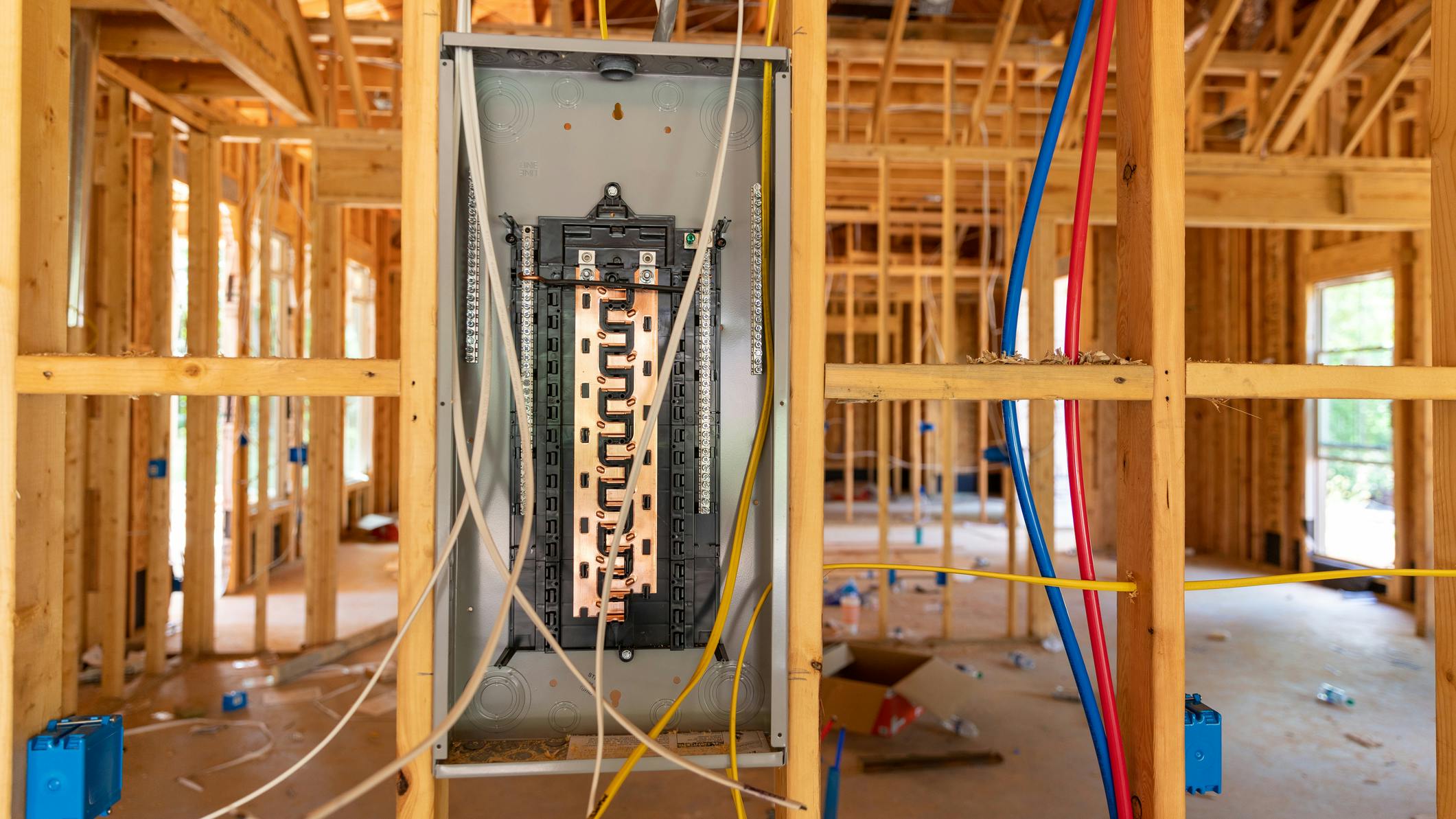

For the 2026 NEC, new Sec. 120.13 was added to Art. 120. It is important to first understand that the calculation being done in Sec. 120.13 is not factoring into the overall dwelling load calculation. This calculation is being used to determine the proper number of dwelling unit branch circuits. A branch-circuit load calculation must be performed based on 3VA/sq ft multiplied by the calculated square footage of the dwelling unit, based on Sec. 120.5(C). A calculation could look like this:
- 5,000 sq ft dwelling unit × 3VA/sq ft = 15,000VA ÷ 120V = 125A
- For 15A, 2-wire circuits, the formula would be: 125 ÷ 15 = 8.33, meaning this would require at least 9 total 15A, 2-wire branch circuits
- For 20A, 2-wire circuits, the formula would be: 125 ÷ 20 = 6.25, meaning this would require at least 7 total 20A, 2-wire branch circuits
These branch circuits from Sec. 120.13 would be in addition to those listed from the required branch circuits in Sec. 210.11(C):
- Small-Appliance Branch-Circuits (minimum of two)
- Laundry Area Branch-Circuit (minimum of one)
- Bathroom Branch-Circuit (minimum of one)
- Garage Branch Circuit (minimum of one)
Based on the branch circuits calculated in accordance with Sec. 120.13 and the requirements of Sec. 210.11(C), the electrical panel in this dwelling unit could contain between 12 and 14 single-pole breakers, in addition to circuits for appliances such as ranges, dryers, and dishwashers. The purpose of adding Sec. 120.13 was to ensure that the total number of branch circuits for a dwelling unit is not reduced, even though the volt-amp values in
Sec. 120.41 were lowered. Reducing the calculation from 3VA/sq ft to 2VA/sq ft could lead to fewer general-purpose branch circuits being required. This, in turn, could result in overloaded circuits, which is why maintaining an adequate number of branch circuits remains a critical focus.
Enforcement of the NEC change
The changes to these Sections will be something that electrical contractors, electricians, and electrical inspectors who are performing residential work will need to be aware of. It would be ideal to have both Sections that changed verified during the plans review stage or, at a minimum, during the rough-in stage when electrical plan review is not necessary for new residential homes within a jurisdiction.
One suggestion to comply with meeting the proper number of branch circuits might be to have all branch circuits installed on circuit breakers in the electrical panel during the rough-in inspection stage, so the electrical inspector can ensure the proper quantity of branch circuits is present before wall coverings, like insulation and drywall, are installed. After all, finding a violation after this stage of a project may become a difficult and costly remedy.
Potential impact of the NEC change
The overall positive impact of these changes on the industry includes the potential for reduced overall electrical service sizes due to the lowered volt-amp (2VA) requirements outlined in Sec. 120.41, which could help reduce overall construction costs. Additionally, the addition of Sec. 120.13, along with the use of a higher volt-amp (3VA) rating, will help ensure an adequate number of branch circuits, reducing the likelihood of homeowners experiencing circuit overloading.
