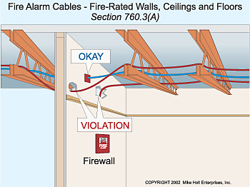

Relation to other articles. Art. 760 doesn't stand alone. For example, 300.21 requires you to use approved methods to provide firestops for fire alarm circuits installed through fire-resistant-rated walls, partitions, floors, or ceilings to maintain the fire resistance rating. You must install cables through fire-rated assemblies with an approved fire-stop material per the specific instructions supplied by the manufacturer of the specific type of cable and construction material. When you make any opening in fire-resistant walls, floors, or ceilings, you must do so in a way that doesn't substantially increase the possible spread of fire or products of combustion (Fig. 1.)
