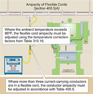

Ampacity
Tables 400.5(A) and 400.5(B) list the allowable ampacity for flexible cords and flexible cables with not more than three current-carrying conductors at an ambient temperature of 86°F. The tables assume copper conductors.
The ampacity from Table 400.5(A) or Table 400.5(B) may need to be adjusted as follows:
  • If the number of current-carrying conductors in a cable or raceway exceeds three, adjust the allowable ampacity of each conductor with the multipliers listed in Table 400.5.
  • If the ambient temperature exceeds 86°F, the temperature correction factors listed in Table 310.16 are used to adjust the flexible cord or cable ampacity (Fig. 1).
