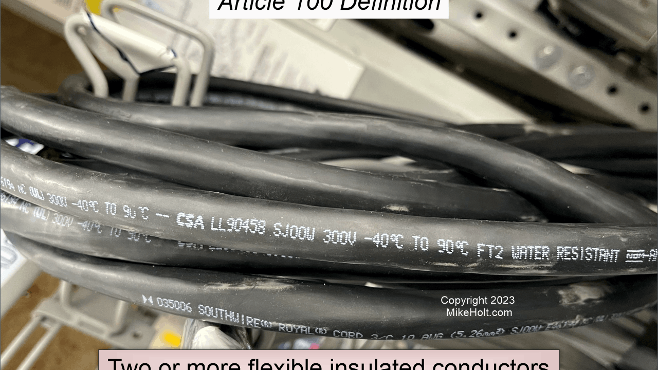

A “flexible cord” is two or more insulated conductors enclosed in a flexible covering [Art. 100] (Fig. 1).
The NEC does not consider flexible cords to be a wiring method like those addressed in Chapter 3 because they are not used as part of the wiring in the construction of a building.
Flexible cords (and their fittings) must be suitable for the use and location [Sec. 400.3]. The use of flexible cords must conform to the descriptions in Table 400.4. The suffix “W” at the end of a flexible cord type designates it is sunlight resistant and suitable for wet locations [Table 400.4, Note 9].
