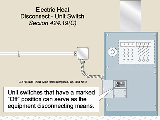

If the fixed electric space-heating equipment doesn't have supplementary overcurrent protection, then you can use the branch-circuit circuit breaker as the disconnecting means [424.19(B)]. That circuit breaker must be within sight of the heater or be capable of being locked in the open position.
You can also use the switch on the heater unit itself as a disconnect, if it has a marked “off” position that is an integral part of the equipment, and the switch disconnects all ungrounded conductors of the circuit [424.19(C)] (Fig. 1).
