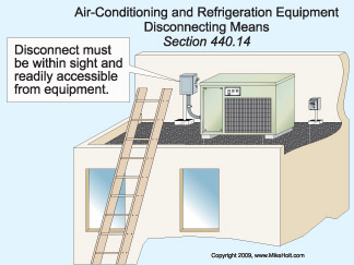

Disconnecting means. Locate the disconnecting means within sight from — and readily accessible from — the A/C equipment [440.14]. "Within sight" means visible and not more than 50 ft from the equipment [Art. 100] (Fig. 1).
You can mount the disconnecting means on or within the A/C equipment, but you can't locate it in access panels — or where it will obscure the equipment nameplate (Fig. 2).
Two exceptions to this rule exist. One is that an accessible attachment plug and receptacle can serve as the disconnecting means. The receptacle for the attachment plug doesn't have to be readily accessible [440.14 Ex 2].The other is that you don't need to place a disconnecting means within sight from the equipment, if you meet all of the following conditions [440.14 Ex 1]:
