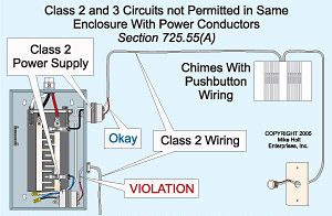

You cannot place Class 2 or 3 conductors in any enclosure, raceway, or cable with conductors of electric light, power, Class 1, or nonpower-limited fire alarm circuits, except as permitted in 725.55(B) through (J), as shown in Fig. 1.
For example, you can install Class 2 and 3 circuits in the same enclosure as electric light, power, Class 1, and nonpower-limited fire alarm circuits if they are separated by a barrier (Fig. 2).
