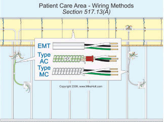

Equipment grounding. You have to provide each branch circuit serving a patient care area with an effective ground-fault current path [517.13, as described in 250.2]. But how? One way is to install those circuits in metal raceway. Alternatively, you can install those circuits in a cable having a metallic armor or sheath that qualifies as an equipment grounding conductor (EGC) per 250.118 (Fig. 1).
  • The metal outer sheath of AC cable is listed as an EGC, because it contains an internal bonding strip in direct contact with the metal sheath of the cable [250.118(8)].
  • The metal outer sheath of interlocked Type MC cable is not listed as an EGC, unless it contains a bare aluminum conductor that makes direct contact with the metal sheath of the cable [250.118(10)(a)].
