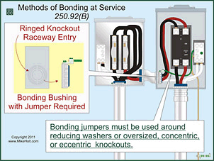

If a panel knockout is oversized, concentric, or eccentric, or uses reducing washers, bond around that opening. Use a bonding jumper, not a standard locknut (Fig. 1).
Fig. 1. If a panel knockout is oversized, concentric, or eccentric - or uses reducing washers - use a bonding jumper, not a standard locknut.
The NEC gives you the choice of four methods for ensuring electrical continuity at service equipment, service raceways, and service conductor enclosures [250.92(B):
  1. Bonding jumpers. Bond metal parts to the service neutral conductor. This requires a main bonding jumper [250.24(B) and 250.28]. Because the service neutral conductor provides the effective ground-fault current path to the power supply [250.24(C)], you don’t have to install an equipment grounding conductor within PVC conduit containing service-entrance conductors [250.142(A)(1) and 352.60 Ex 2] (Fig. 2).
  2. Threaded fittings. Terminate metal raceways to metal enclosures by threaded hubs on enclosures (if made wrenchtight).
  3. Threadless fittings. Terminate metal raceways to metal enclosures by threadless fittings (if made tight).
  4. Other listed devices. These include bonding-type locknuts, bushings, wedges, or bushings with bonding jumpers.
Fig. 2. An SSBJ isn't required within nonmetallic conduit because the service neutral conductor serves as the effective ground-fault current path.
This last method needs more discussion. To bond one end of the service raceway to the service neutral conductor, you must use a listed bonding wedge or bushing with a bonding jumper. Size it per Table 250.66, based on the area of the largest ungrounded service conductors within the raceway [250.102(C)].
When a metal raceway containing service conductors terminates to an enclosure without a ringed knockout, you can use a bonding-type locknut. Bonding one end of a service raceway to the service neutral provides the low-impedance fault current path to the source (Fig. 3).
