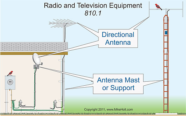

Article 810 contains the installation requirements for the wiring of television and radio receiving equipment (Fig. 1). The types of equipment covered includes:
• Satellite antennas. Large satellite dish antennas (often about 6 ft in diameter) usually have a motor that moves the dish to focus on different satellites. The smaller satellite dish antennas (18 in. in diameter) are usually aimed at a single satellite.
• Roof-mounted antennas for AM/FM/XM radio reception.
• Amateur radio transmitting and receiving equipment, including HAM radio equipment.
Fig. 1. Article 810 covers requirements for antenna systems (including satellite dishes) for radio and television receiving equipment, and amateur and citizen band radio transmitting and receiving equipment.
