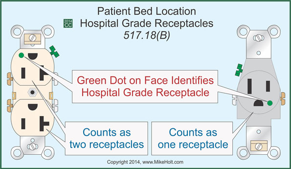

Inpatient sleeping beds or procedure table beds must have a minimum of eight hospital-grade receptacles (single, duplex, quadplex, or any combination of the three) [Sec. 517.18(B)] (Fig. 3).
Fig. 3. Each patient bed location requires at least eight hospital-grade receptacles. They can be a single, duplex, quadplex, or any combination of the three.
“Hospital-grade” receptacles aren’t required in treatment rooms of clinics, medical and dental offices, or outpatient facilities because these locations don’t have a “patient bed location” as defined in Sec. 517.2.
