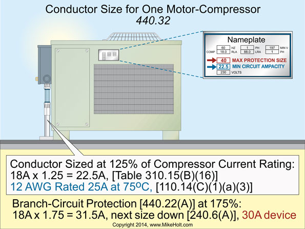

Branch-circuit conductors to a single motor-compressor must have an ampacity not less than 125% of the motor-compressor rated-load current or the branch-circuit selection current — whichever is greater [440.32].
Let’s run through an example to show how to properly size an overcurrent protection device and choose an appropriate conductor size.
Fig. 2. This example shows how to size the conductor and overcurrent device for an 18A motor compressor with 75°C terminals.
What size conductor and overcurrent device are required for an 18A motor compressor with 75°C terminals (Fig. 2)?
Step 1:  Determine the branch-circuit conductor [Table 310.15(B)(16) and 440.32]
18A × 1.25 = 22.50A
A 12 AWG conductor is rated 25A at 75°C [110.14(C)(1)(a)(3), Table 310.15(B)(16)]
Step 2:  Determine the branch-circuit protection [240.6(A) and 440.22(A)]
18A × 1.75 = 31.50A, next size down = 30A
If the 30A short-circuit and ground-fault protection device isn’t capable of carrying the starting current, then you can size the protective device up to 225% of the equipment load current rating.
18A × 2.25 = 40.50A, next size down 40A
Therefore, you can use a 30A or 40A overcurrent device to protect a 12 AWG conductor for an air-conditioning circuit. See Sec. 240.4(G) for details.
