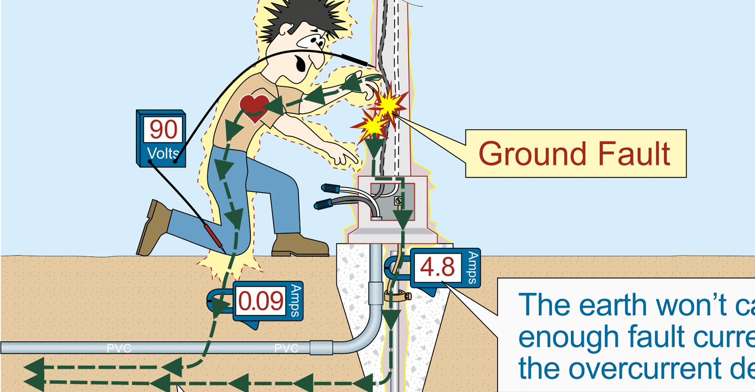

Grounding
Metal equipment of signs, outline lighting systems, and skeleton tubing must be connected to the circuit equipment grounding conductor (EGC) of a type recognized in Sec. 250.118 [Sec. 600.7(A)(1)]. Size the EGC of the wire type per Sec. 250.122, based on the rating of the overcurrent protection device. EGC connections must be made per Sec. 250.130, in a method specified in Sec. 250.8 [Sec. 600.7(A)(2)].
Auxiliary grounding electrodes aren’t required for signs and outline lighting. But, if installed, they must comply with Sec. 250.54.
Don’t use the earth as the effective ground-fault current path required by Sec. 250.4(A)(4) and Sec. 250.4(A)(5). The contact resistance of a grounding electrode to the earth is high, so insignificant ground-fault current returns to the electrical supply source via the earth. Using the earth as the effective ground-fault current path means the circuit overcurrent protection device probably won’t open to clear a ground fault (Fig. 3).
