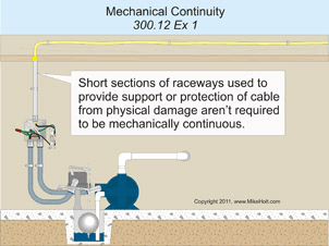

Q. Is it allowable to install a cable wiring method inside a circular raceway for a short distance for support or protection?
A. The general rule covering the mechanical continuity of raceways requires that raceways and cable sheaths must be mechanically continuous between boxes, cabinets, and fittings [300.12]. However, there are a couple of exceptions to note:
Ex 1: Short sections of raceways used to provide support or protection of cable from physical damage aren’t required to be mechanically continuous [250.86 Ex 2 and 300.10 Ex 1], as shown in Fig. 1.
Ex 2: Raceways at the bottom of open-bottom equipment, such as switchboards, motor control centers, and transformers, aren’t required to be mechanically secured to the equipment.
When raceways are stubbed into an open-bottom switchboard, the raceway, including the end fitting, can’t rise more than 3 in. above the bottom of the switchboard enclosure [408.5].
