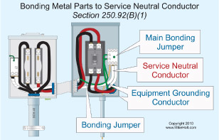

Q. What are the bonding requirements for service raceways and enclosures containing service conductors?
A. The requirements are contained in 250.92, and read as follows:
(A) Bonding of Services. The metal parts of equipment indicated in (A)(1) and (A)(2) must be bonded together in accordance with 250.92(B).
(1) Metal raceways containing service conductors.
(2) Metal enclosures containing service conductors.
Author's comment: Metal raceways or metal enclosures containing feeder and branch circuit conductors are required to be connected to the circuit equipment grounding conductor in accordance with 250.86.
(B) Methods of Bonding. Metal raceways and metal enclosures containing service conductors must be bonded by one of the following methods:
(1) Neutral Conductor. By bonding the metal parts to the service neutral conductor, as shown in Fig. 1.
Author's comment: A main bonding jumper is required to bond the service disconnect to the service neutral conductor [250.24(B) and 250.28]. At service equipment, the service neutral conductor provides the effective ground-fault current path to the power supply [250.24(C)]; therefore, an equipment grounding conductor isn't required to be installed within PVC conduit containing service-entrance conductors [250.142(A)(1) and 352.60 Ex 2].
(2) Threaded Fittings or Entries. By using threaded couplings or threaded entries made up wrench tight.
(3) Threadless Fittings. By using threadless raceway couplings and connectors made up tight.
(4) Bonding Fittings. When a metal service raceway terminates to an enclosure with a ringed knockout, a listed bonding wedge or bushing with a bonding jumper must be used to bond one end of the service raceway to the service neutral conductor. The bonding jumper used for this purpose must be sized in accordance with Table 250.66, based on the area of the service conductors within the raceway [250.92(B)(4) and 250.102(C)].
Author's comment: When a metal raceway containing service conductors terminates to an enclosure without a ringed knockout, a bonding-type locknut can be used. A bonding locknut differs from a standard locknut in that it has a bonding screw with a sharp point that drives into the metal enclosure to ensure a solid connection. Bonding one end of a service raceway to the service neutral provides the low-impedance fault current path to the source, as shown in Fig. 2.
