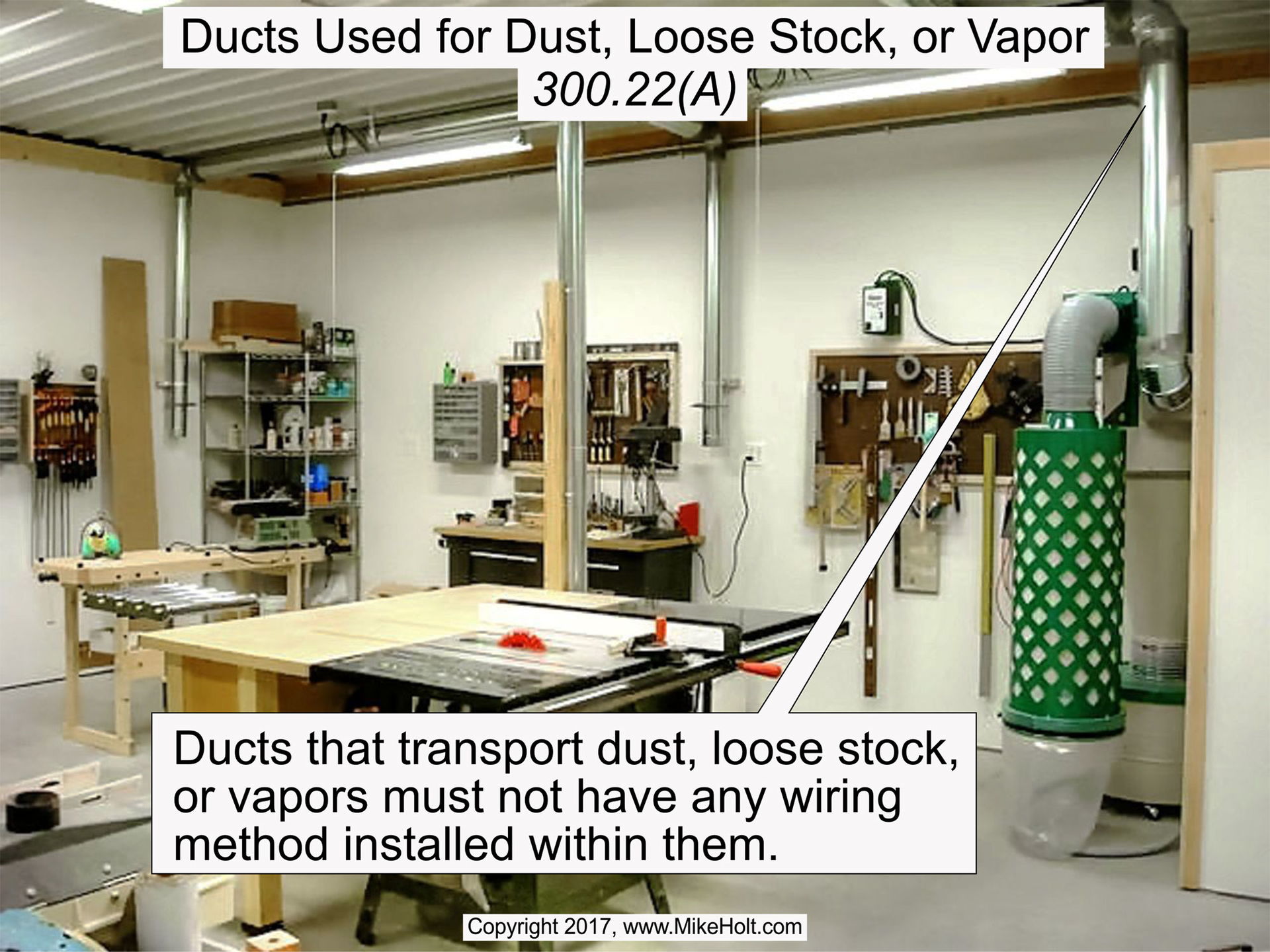

Q.  What are the 2017 Code rules regarding wiring in ducts used to transport dust, loose stock, or vapors?
Scroll Down for the Answer
A. Ducts that transport dust, loose stock, or flammable vapors must not have any wiring method installed within them [300.22(A)].
