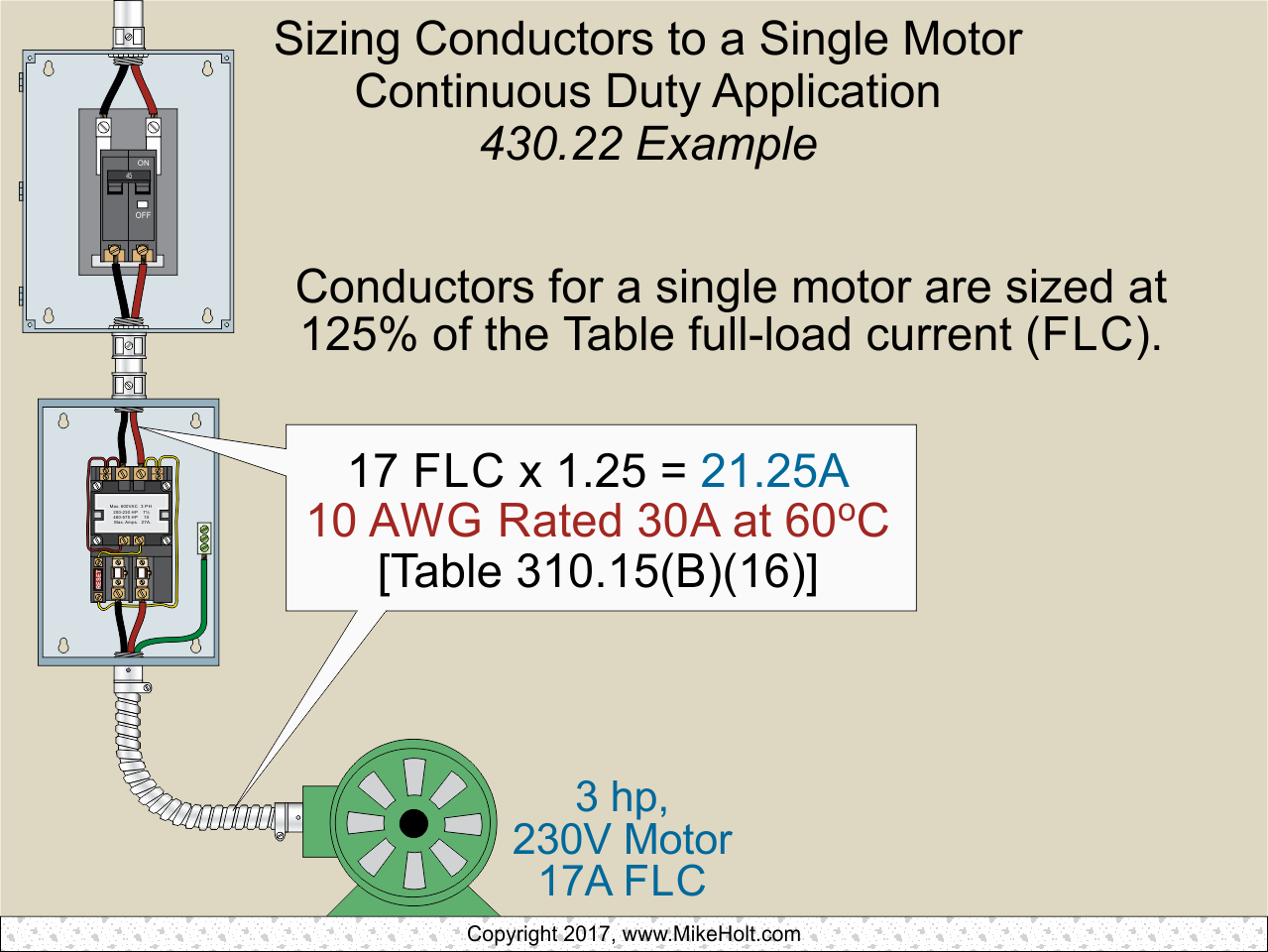

Q. What is the Code required method of sizing the conductors to a single continuous-duty motor?
See answer below.
A. Conductors to a single motor must be sized not less than 125% of the motor FLC rating as listed in Table 430.247 [Direct-Current Motors], Table 430.248 [Single-Phase Motors], or Table 430.250 [Three-Phase Motors] [Sec. 430.22].
Example: What size circuit conductor is required for a 3 hp, 230V, single-phase motor?
Solution: Determine the branch-circuit conductor size based on the motor’s FLC [Sec. 430.6(A)(1), Sec. 430.22(A) and Table 310.15(B)(16)].
3 hp, 230V Motor FLC = 17A [Table 430.248]
17A × 1.25 = 21.25A
Answer: 10 AWG rated 30A at 60°C [Table 310.15(B)(16)]
The branch-circuit circuit breaker overcurrent protection is based on motor’s FLC [240.6(A), 430.6(A)(1), 430.52(C)(1), and Table 430.248].
